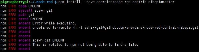

gerade am neu Installieren von Nibepi mit Beckers Anleitung (danke!), vielleicht habt ihr eine Ahnung?
node.js Version habe ich jetzt 12 LTS, aktuelles node-red
2021/20211028315778.jpg
0 info it worked if it ends with ok
1 verbose cli [
1 verbose cli   '/usr/bin/node',
1 verbose cli   '/usr/bin/npm',
1 verbose cli   'install',
1 verbose cli   '--save',
1 verbose cli   'anerdins/node-red-contrib-nibepi#master'
1 verbose cli ]
2 info using npm@6.14.15
3 info using node@v12.22.7
4 verbose npm-session 0ff0a7f7da861801
5 silly install loadCurrentTree
6 silly install readLocalPackageData
7 silly fetchPackageMetaData error for github:anerdins/node-red-contrib-nibepi#master Error while executing:
7 silly fetchPackageMetaData undefined ls-remote -h -t ssh://git@github.com/anerdins/node-red-contrib-nibepi.git
7 silly fetchPackageMetaData spawn git ENOENT
8 timing stage:rollbackFailedOptional Completed in 3ms
9 timing stage:runTopLevelLifecycles Completed in 809ms
10 verbose stack Error: spawn git ENOENT
10 verbose stack     at Process.ChildProcess._handle.onexit (internal/child_process.js:268:19)
10 verbose stack     at onErrorNT (internal/child_process.js:470:16)
10 verbose stack     at processTicksAndRejections (internal/process/task_queues.js:84:21)
11 verbose cwd /home/pi/.node-red
12 verbose Linux 5.10.63-v7+
13 verbose argv "/usr/bin/node" "/usr/bin/npm" "install" "--save" "anerdins/node-red-contrib-nibepi#master"
14 verbose node v12.22.7
15 verbose npm  v6.14.15
16 error code ENOENT
17 error syscall spawn git
18 error path git
19 error errno ENOENT
20 error enoent Error while executing:
20 error enoent undefined ls-remote -h -t ssh://git@github.com/anerdins/node-red-contrib-nibepi.git
20 error enoent
20 error enoent
20 error enoent spawn git ENOENT
21 error enoent This is related to npm not being able to find a file.
22 verbose exit [ 1, true ]
  •  Andreas90
29.10.2021  (#732)
hat sich erledigt, git war nicht installiert 😐

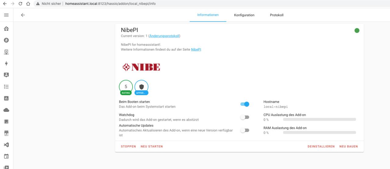

13.11.2021  (#740)
Gut zu wissen.
2021/20211113755768.png
Die ersten Schritte für das Homeassistant AddOn sind schon gemacht.
  •  denis
13.11.2021  (#741)
2021/20211113289671.png
So das AddOn rennt auch schon soweit. Es fehlt nun also nur noch der Prodino MKR. Ich mache mich dann mal an das Refactoring des NibePI Modules. 50% des Codes können nur für den NibeGW only Einsatz raus.
