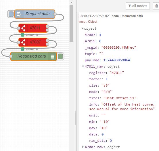

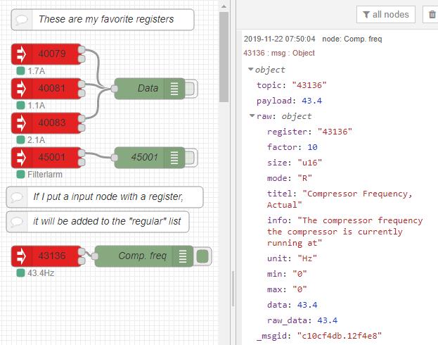

NibePi does not have it's own favorite register. I meant the usb log.set favorite register.
2019/20191122168935.png
Here's an example of the NodeRED nodes that are coming. This is the request node, it request live data from the heatpump. And it takes 2,1 seconds per request node. But. If one of the registers is a part of the favorite registers, it will respond within 0,5 seconds. It will not make a "slow request" if the register is part of the favorites. In that 47011_raw section everything from the registerfile is included. It's a good idea with the timestamp. I will add a timestamp i that raw message. For example, the timestamp will be the same for the favorite registers , because I will set the timestamp when that long message arrives.
2019/20191122937849.png
The Input node either adds the register you choose to the "Get regulary list" or gets the data from the favorite registers when data arrives every 0,5 second.
I will add the timestamp. That's a very good idea.

So if I get that right a "request" node allows to request multiple registers. If all of the registers are not in the usb log set favorites, the whole request (for all of the registers) takes 2,1 seconds. If it is in the favorites it is 0,5s but only for the favorites.

Unfortunally a request node only request one register and it takes 2,1 seconds. If it happens to be a favorite the request is faster.
This is a limit that comes with the heatpump. Modbus40 wont improve this either. Because from my understanding it dosent support reading multiple registrers at one time.

You're correct in your first part. That's my understanding too.
But NibePi works a little bit different, first of all the backend or the worker does not store any data waiting to be requested. NibePi only works with live/most-recent accurate data.
NibePi is a subscribe/publish/request unit. If it has data availible it publishes it. So it will publish the favorite registers every 0,5 seconds.
It also has a built in "regularQueue" which other registers can be included in. The registers in that queue will be requested from every 2,1 second in order. So a regularQueue of 10 registers will take 21 seconds to get. So the delay will be 21 seconds for every register. Again this is not specifik for NibePi, it's the same with Modbus40. These registers will get published regulary.
