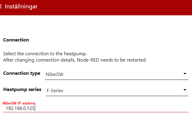

  •  nibepi
13.9.2020  (#511)
chrismo schrieb: AFAIK this is currently not possible but will be added to NibePi in an upcoming release.A
Actually 1.1 has beed released (and translated in most part to german and english)
https://github.com/anerdins/nibepi/blob/master/README.en.md
2020/20200913687307.png
So you can use a prodino with NibePi running on a own separate Raspberry Pi, still no guide though how to install it on a already running system.
This docker-image supports running on a docker.
https://hub.docker.com/r/anerdins/nibepi-base
Fully functional MQTT support

  •  KoMa
13.9.2020  (#519)
Thanks a lot!
nibepi schrieb: I have got some other reports that auth in MQTT client isnt working, I will take a look at it as soon as I can. So the problem is probably not in your setup.
If you want me to test/try something please tell me.
may I ask what the config.json is needed for and shouldn't this file be updated from the admin dashboard?
also Ido not use log.set because I want to query only specific registers every x minutes.
Is there a way to configure how long the system should wait before querying again?
And am I right that all Register are queried that are configured in config.json or used in a dashboard?
Im sorry I do not use Facebook it may be already discussed.
Thanks a lot,
 KoMa
